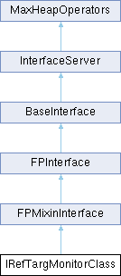

Inheritance diagram for IRefTargMonitorClass:
