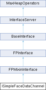

Inheritance diagram for ISimpleFaceDataChannel:
