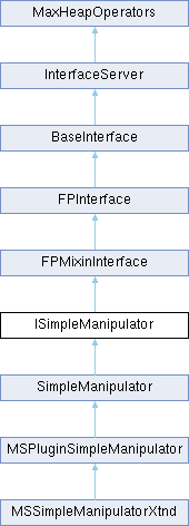

Inheritance diagram for ISimpleManipulator:
