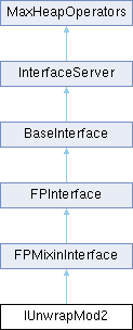

IUnwrapMod2 Class Referenceabstract
#include <C:/adskgit/3dsmax/3dsmax/3dswin/src/maxsdk/include/iunwrap.h>
Inheritance diagram for IUnwrapMod2:
