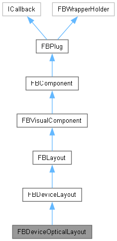

Layout for optical device. More...
#include <fbdevicelayout.h>
Public Types | |
| enum | FBDeviceOpticalGUIOptions { kGUIModelOpticalList = 1<<0 , kGUIModelOpticalCreate = 1<<1 , kGUIModelOpticalDampingTime = 1<<2 , kGUIDeviceStatus = 1<<3 , kGUIDeviceReset = 1<<4 , kGUIViewer = 1<<5 } |
| Different options for optical device GUI. More... | |
Public Types inherited from FBLayout | |
| enum | FBSplitStyle { kFBNoSplit = 0 , kFBHSplit = 1 , kFBVSplit = 2 , kFBHVSplit = 3 } |
| Type of split style (sub-division) for layout. More... | |
Public Member Functions | |
| FBDeviceOpticalLayout (FBDevice *pDevice=NULL) | |
| Constructor. | |
| virtual bool | FBCreate () override |
| Open Reality Creation function. | |
