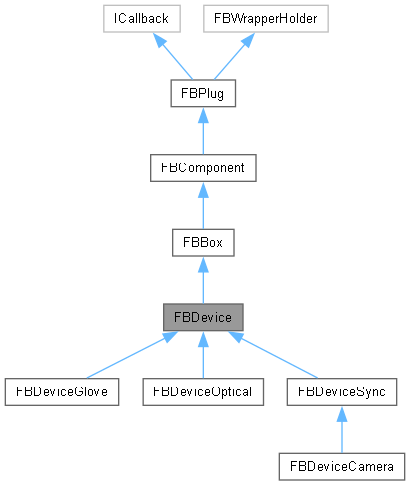

FBDevice Class Reference
Base Device class. More...
#include <fbcore.h>
Inheritance diagram for FBDevice:
