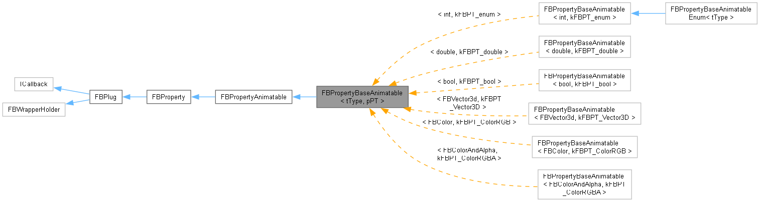

Public Types | |
| typedef tType | ValueType |
| Property Value Type. | |
Public Member Functions | |
| FBPropertyBaseAnimatable () | |
| Constructors. | |
| FBPropertyBaseAnimatable (const FBPropertyBaseAnimatable< tType, pPT > &pValue) | |
| ~FBPropertyBaseAnimatable () | |
| Destructor. | |
| void | operator= (tType pValue) |
| Overloaded = operator. | |
| operator tType () const | |
| Overloaded cast to tType operator. | |
| virtual FBPropertyType | GetPropertyType () override |
| Get the property's type. | |
