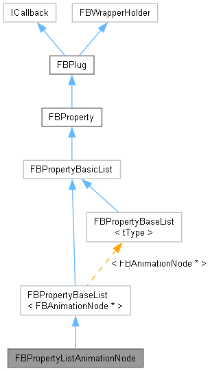

List of animation nodes. More...

Public Member Functions inherited from FBPropertyBaseList< FBAnimationNode * > | |

Public Member Functions inherited from FBProperty | |

Public Member Functions inherited from FBWrapperHolder | |

virtual |
Add an animation node to the list.
| pItem | Animation node to add. |
Implements FBPropertyBaseList< FBAnimationNode * >.
| FBAnimationNode * Find | ( | const char * | pNodeName | ) |
Find an animation node.
| pNodeName | String name of animation node to find. |
| FBAnimationNode * Find | ( | FBBox * | pOriginalOwner, |
| const char * | pDataType | ||
| pOriginalOwner | Original Owner of the AnimationNode. |
| pDataType | DataType of the AnimationNode. |
| FBAnimationNode * FindByLabel | ( | const char * | pNodeLabel | ) |
Find an animation node by label name.
| pNodeLabel | UI name of animation node to find. |
virtual |
Get a count of the number of animation nodes in list.
Implements FBPropertyBasicList.
virtual |
Overloaded [] operator.
| pIndex | Index of animation node to access. |
virtual |
Remove an animation node from the list.
| pItem | Animation Node to remove. |
Reimplemented from FBPropertyBaseList< FBAnimationNode * >.
virtual |
Remove an animation node from pIndex.
| pIndex | Index of animation node to remove. |
