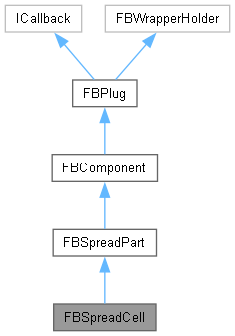

Spreadsheet cell. More...
#include <fbcontrols.h>

Spreadsheet cell.
Definition at line 1511 of file fbcontrols.h.
