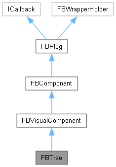

Tree list view.
Definition at line 1900 of file fbcontrols.h.
