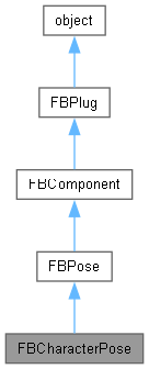

Used to work with character poses. More...
This class exposes the object used to store the pose of objects.
