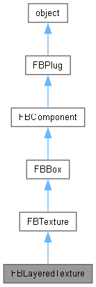

LayeredTexture class. More...
#include <pyfbsdk.h>
This class is used to encapsulate list of textures. User could subclass this class to support customized blending & compostion modes. See /OpenRealitySDK/Samples/miscellaneous/texture_template/ for example.
FBLayeredTexture | ( | str | pName | ) |
Constructor.
pName | Name of texture media. Can be a NULL pointer. If set, this will create a FBVideo object used as the Video property. |
