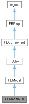

Null object class. More...
#include <pyfbsdk.h>
