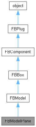

Plane model class. More...
#include <pyfbsdk.h>

Plane model class.
FBModelPlane | ( | str | pName | ) |
Constructor.
pName | Name of Plane. |
