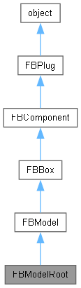

| | FBModelRoot (str pName) |
| | Constructor.
| | FBModel (str pName) |
| | Constructor.
