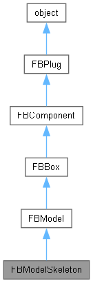

Root object class. More...
#include <pyfbsdk.h>
Public Member Functions | |
| FBModelSkeleton (str pName) | |
| Constructor. | |
| GetSkinModelList (FBModelList pSkinModelList) | |
| Return the list of skin model associated with this Skeleton(Bone), which could be the deformable skins connected via cluster, or non deformable skins which are parented directly under this bone. | |
