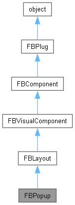

Popup window.
This class lets a window (inheriting from FBLayout) be created for another interface.
| FBPopup | ( | ) |
Constructor.
| Close | ( | bool | pOk = False | ) |
Close popup.
| pOk | Equivalent of OK button clicked if true (default = false). |
| bool Show | ( | FBVisualComponent | pParent = None | ) |
Show popup.
| pParent | Parent object for popup |
| str Caption |
Read Write Property: Caption to display in popup.
| bool Modal |
Read Write Property: Modal?
