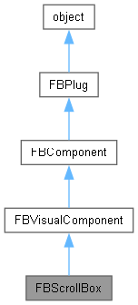

Scroll Box.
This class provides a layout that will be automatically managed with a scrollbar according to the specified width and height. This provides a way to add dynamic UI control.
| FBScrollBox | ( | ) |
Constructor.
| FBLayout Content |
Read Property: an empty layout in which you can add scrollable content.
