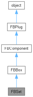

Objects Set class. More...
#include <pyfbsdk.h>
Public Member Functions | |

Public Member Functions inherited from FBBox | |

Public Member Functions inherited from FBComponent | |

Public Attributes inherited from FBPlug | |

Objects Set class.
This class is an interface to manipulate object sets in the scene. Note: an item cannot be in two FBSet objects at once. Also, an FBGroup cannot contain FBSet objects, although an FBSet object can contain an FBGRoup.
