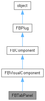

Tab panel. More...
#include <pyfbsdk.h>
Public Member Functions | |
| FBTabPanel () | |
| Constructor. | |
Public Member Functions inherited from FBVisualComponent | |
| FBVisualComponent () | |
| Constructor. | |
