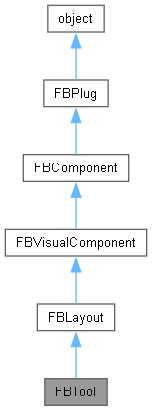

Tool class. More...
#include <pyfbsdk.h>

Tool class.
See samples: MBFileRefDemo.py, CloseTool.py, MoveResizeToolExample.py, SafeToolCreationExample.py, ToolCommunicationReceiver.py, ToolNativeWidgetHolder.py.
Constructor used when creating tools not in the Tools menu of MotionBuilder.
| pName | Name of tool, must be an unique name. |
