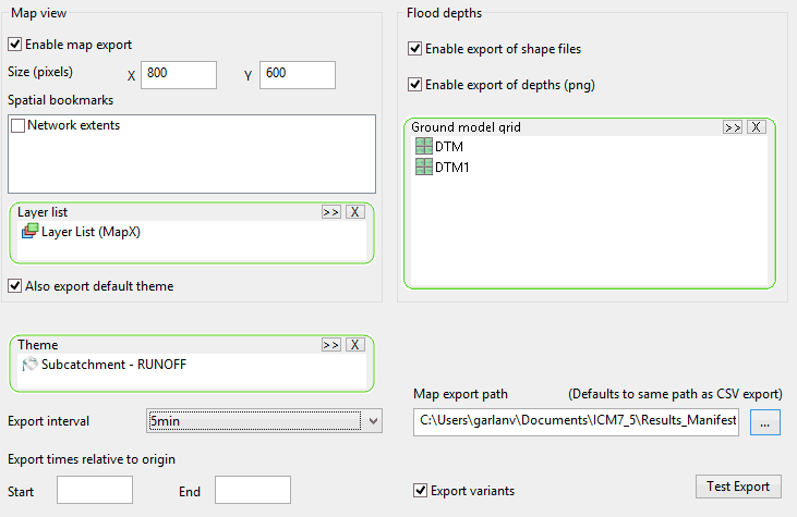

This page of the manifest is used to configure the automatic export of maps to image files (PNG format) and flood depths to shape files (ESRI SHP format) and/or PNG image files in the ICMLive Operator Client, and to test the export settings in InfoWorks ICM. World and projection files for the selected maps will be exported simultaneously.

Enable map export
If checked, enables the map export for the baseline simulation.
Size (pixels)
The width (X) and height (Y) of the exported maps.
Spatial bookmarks
Several maps can be simultaneously exported. These maps can be spatial bookmarks that may have been set for the network, or just the extents of the network.
Select the maps to export by ticking the adjacent check box. The spatial bookmarks are taken from the network used in the simulation specified on the manifest Setup page. If no spatial bookmarks have been defined in the network the only available option will be Network extents.

Layer list
A layer list may be used to specify the display of any map or other background layers for the exported map image file(s).
If no layer list is specified in the Layer box but the Enable map export option is checked, then as default, the layer list specified in the Display page will be used to display the exported map images.
Also export default theme
If a Layer list is specified, checking this box indicates that the default list, specified on the Display page, must also be used in the export operation. This results in two sets of image files being exported; one in which the exported image(s) is displayed according to the default layer settings and the other according to the specified Layer list settings.
Enable export of shape files
If checked, the export of the flood depth results for the baseline simulation as ESRI SHAPE files is enabled.

Enable export of depths (png) If checked, the export of the flood depth results for the baseline simulation as a PNG file is enabled.
The flood depths on the Ground model grid will be exported as a PNG image file.

The ground model grids, which contains the relevant elevation information for the export of flood depths, must be specified in this box. This is essential for InfoWorks ICM to calculate the depths.

Theme
A GeoPlan theme, which has been saved as a theme object, can be used to specify the display of the exported map image file(s).
Note: If you want to export flood depths, then a theme for the flood object layer must be specified. This theme is required to evaluate the depths, and the depth scale of the flood theme is used to determine the levels at which contours are exported.
If a theme is not specified in the Theme box, but the Enable map export and/or Enable export of shape files option is checked, then as default, the theme specified in the Display page is used for displaying the exported map images or flood depth files.
Export interval
The export time interval for the map or flood depth files. This applies to all the maps selected in the Spatial bookmarks section.
You can select the Maxima option or select a particular 'result timestep' from the dropdown.
Maxima - export map(s) or flood depths corresponding to the overall maximum results values only.
'Result timestep' - export map(s) corresponding to the overall maximum results values as well as a map/flood depth for each timestep.
If the Also export default theme box is checked, and an appropriate alerts theme / ground model combination is specified in the Display page, then flooding may be seen in the exported images.
Export times relative to origin
If you want to only export map and/or flood depth results within a certain time period, relative to the run origin time, then specify a time in the Start and/or End fields.
If both these fields are left blank then the whole run period from the hindcast time to the forecast time will be exported.
If you only specify a Start time, then all maps and/or flood depths results after that start time relative to the run origin, will be exported.
Similarly, if you only specify an End time, then all maps and/or flood depth files from the origin until the end time, will be exported.
If a Export interval 'result timestep' and a Start and End time are specified, then the results are limited to the specified interval between the start and end time relative to the run origin. For example, if you specify a Start time of 0 and an End time of 2h, and the Export interval is set to a 'result timestep' of 1hrs then, providing the forecast period is at least 2 hours, three map and/or flood depth (shape and/or png) files will be exported; one at the origin, the second an hour later, and the third, two hours later.
Export variants
If checked, the export of results for variant runs is enabled.
Map export path
The path of the folder to which the results are to be exported. This can be typed-in or browsed for using .
If no folder is specified, then the results will be exported to the same folder specified in the Target field in the Result CSV export page.
Test Export
Enabled when a path has been typed in or selected in the target box of the Map export path field.
Exports the maps and/or flood depths specified for the currently selected simulation.
Note: The test export functionality only applies to the baseline simulation selected in the Setup page, not to variant runs, even if the export of variant run maps and/or flood depths has been enabled.
