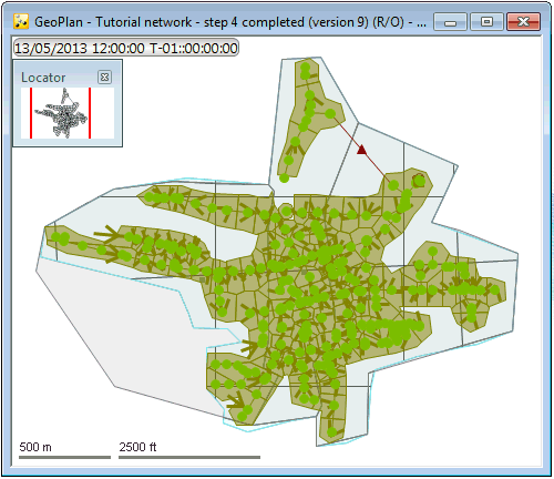

  1. Open the results of the latest simulation which includes the radar rainfall (test TSDB - with rain gauges, Nowcast and Nimrod RADAR data) in the GeoPlan window.
  2. To improve the visibility of the RADAR rainfall theme on the GeoPlan, we are going to hide the Maps GIS layer that was added here:

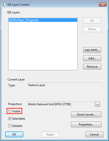

    1. Right-click on the GeoPlan and select GIS Layer control from the context menu.
    2. In the GIS Layer Control dialog, disable the Visible option for the MapC_Projected layer.
    3. Making a layer invisible in the GeoPlan
    4. Click OK to save the changes and close the dialog.

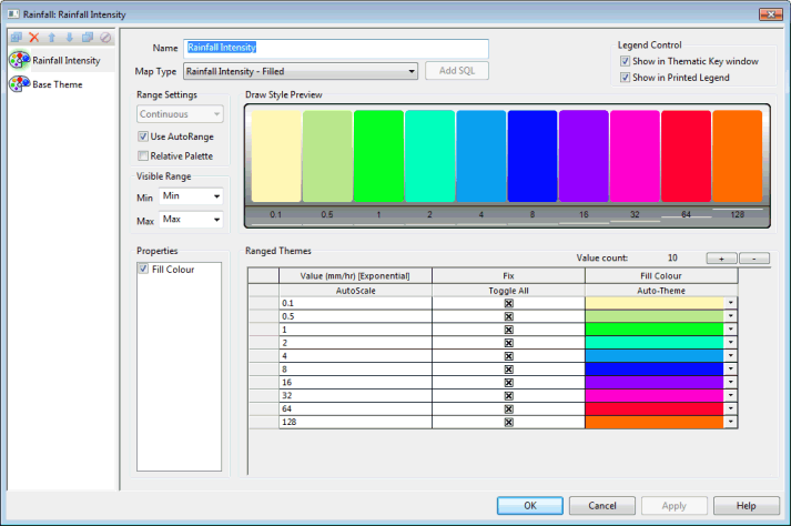

  7. We are going to edit the rainfall theme:
    1. Click the Edit button of the Theme column for the Rainfall Object Layer.
    2. There is a rainfall intensity theme already set up. This theme will be used to show the radar rainfall in each of the cells.
    3. Default Rainfall Theme based on Intensity
    4. Leave the theme as it is and press OK to exit the Layer Theme Editor.

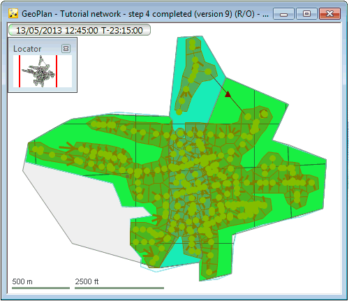

  9. You should now see two grids within the Spatial Rain Zone polygon. The radar data used in this example has different grid for the observed (1km resolution) and forecast (2km resolution and slightly rotated).
  10. Radar cell boundaries displayed on the GeoPlan
  11. Replay the simulation and you should see the radar rainfall passing over the network area.
  12. Replaying the simulation and viewing the RADAR rainfall on the GeoPlan

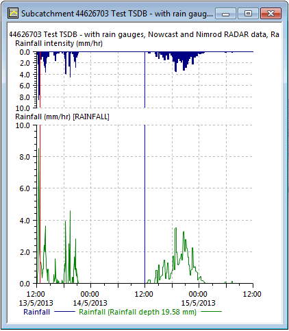

  13. Plot a graph of the rainfall for one of the subcatchments:
    1. Select the Graph tool (Graph Tool) from the Results toolbar.
    2. Select a subcatchment on the GeoPlan.
    3. In the Graph Pick Selection dialog, select Rainfall and click OK.
    4. The blue vertical line indicates the run origin. The rainfall profile is a combination of gauged rainfall, Nimrod data and Nowcast data:
    5. Graphing rainfall time-varying data
    6. Once finished looking at the graph click on the Close dialog button to close the graph.
