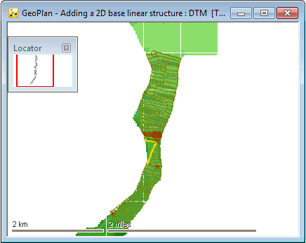

  5. The first step is to add a 2D base linear structure into the 2D zone. These structures can be used to represent walls or dams that stop the flow of water within a 2D zone. The base linear structure we are going to put in is a wall that will collapse partially during the simulation using flood depth as wall removal trigger. First, draw a line in the 2D zone and define it as a 2D base linear structure:

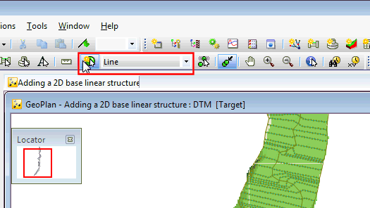

    1. From the New Object toolbar item, select Line as the required object type. Then select the New Object button .
    2. Creating a new line

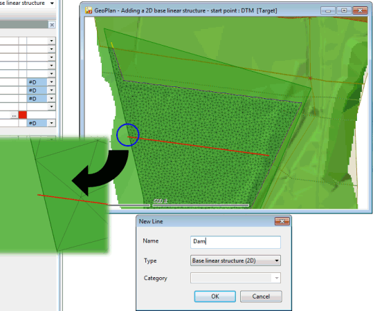

    3. Draw in a new line from the edge of the 2D zone as shown on the screenshot below. When prompted, set the name as Dam. It is also very important to remember to set the line type to Base linear structure (2D).
    4. Note: The line must start before or at the edge of the 2D zone and be slightly shorter than the 2D zone width, as shown in the screenshot below.
  6. Base linear structure (2D) type

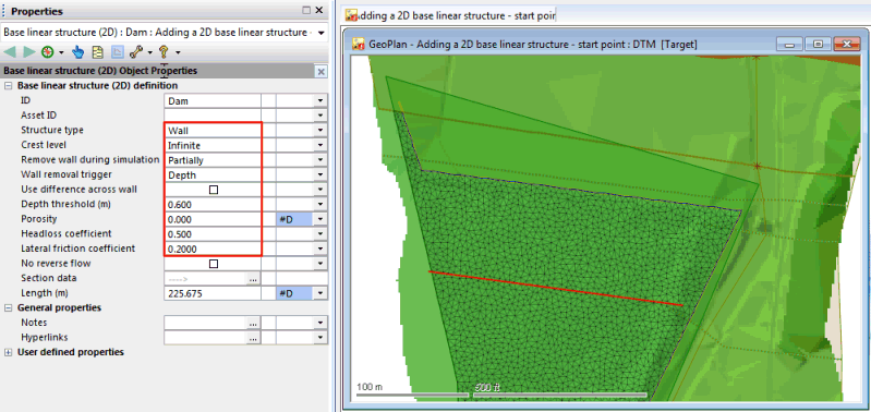

  7. Next, use the Properties tool , select the 2D base line and set the various parameters required. In particular, set the Structure type to Wall and the Crest level to Infinite. Set the Remove wall during simulation field to Partially and Wall removal trigger to Depth.
  8. A wall can be set up for either never collapse, partially collapse (the segment of the wall adjacent to the mesh element in which the condition has been met will collapse) or fully collapse, in which the entire wall collapses, as soon as the condition is met, at any point along the wall. In this tutorial, we use Depth as trigger to remove wall during simulation, set Depth threshold (m) to 0.6 and Porosity to 0. A porosity of 0 is equivalent to a vertical wall which does not allow flow to transfer through it.
  9. All other parameters should be set as in the image below (Headloss coefficient set to 0.5 and Lateral friction coefficient set to 0.2).
  10. Dam Properties

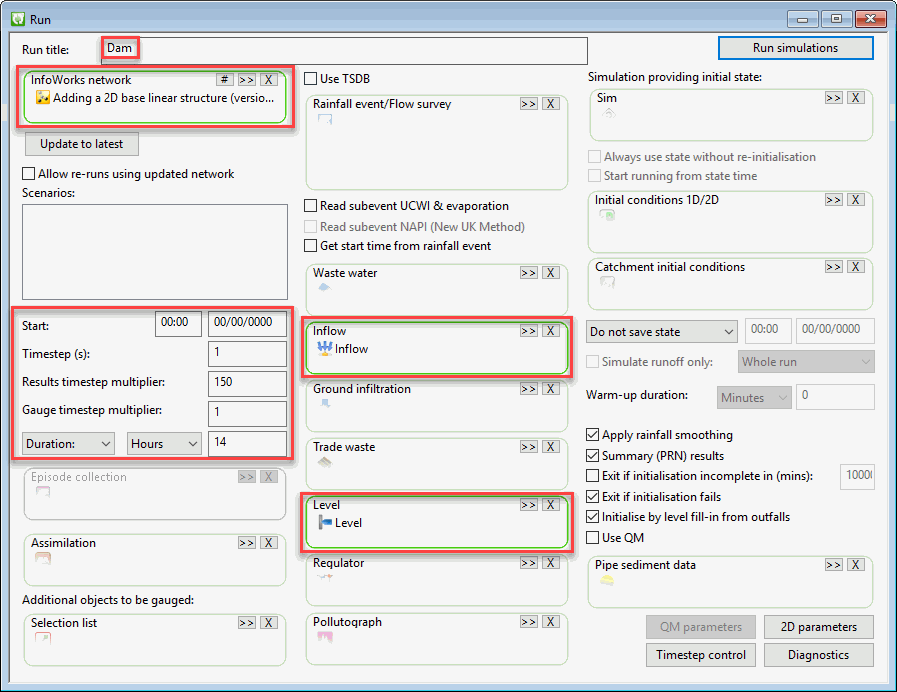

  14. Create a new run and define the run parameters as shown in the screenshot below:
    1. Create a new run by right-clicking the Model Group in the Explorer window.
    2. Select New InfoWorks Run. The Schedule Hydraulic Run View dialog is displayed.
    3. In the Schedule Hydraulic Run View dialog:
      1. Enter a name in the Run title (Dam)
      2. Drag and drop your network (Adding a 2D base linear structure) in the InfoWorks Network drop target.
      3. Drag and drop the Inflow hydrograph in the Inflow drop target (This hydrograph has been added to the model in step 5 of the Building a river model in InfoWorks ICM mini-tutorial).
      4. Drag and drop the Level hydrograph in the Level drop target (This hydrograph has been added to the model in step 5 of the Building a river model in InfoWorks ICM mini-tutorial).
      5. Set the Timestep to 1 second and the Results timestep multiplier to 150.
      6. Set the Simulation time to 14 hours.
    4. It is worth noting that 1D-2D models will typically have a lower timestep than 1D-only models. In this example we will be using 1 second, but below 10 seconds is perhaps more common.

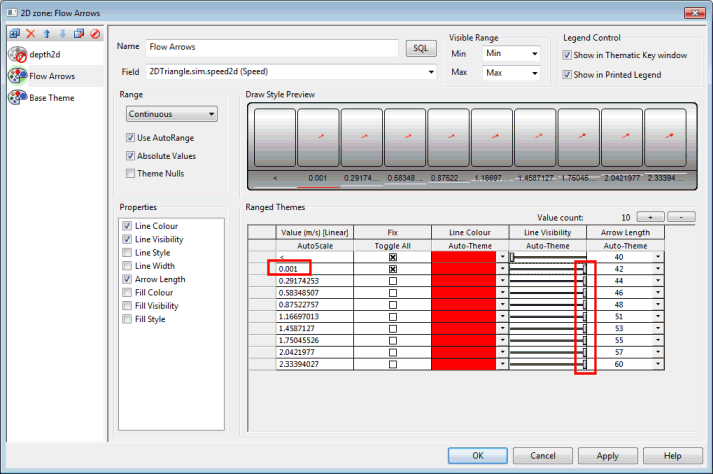

  19. Modify the 2D zone configured in the 2D Zone tutorial so that low flows and depths have a higher visibility. The line visibility is set using the slider in the Line Visibility column. Line visibility is increased (and transparency decreased) by pulling the slider to the right. 100% visibility (and 0% transparency) occurs when the slider is set completely to the right. Do this for all flow values with the exception of negative values. Set the second flow value down in the Ranged Themes grid to 0.001 instead of 0. Click on Apply then OK on the Layer Theme Editor.
    Editing the 2D Zone arrow theme

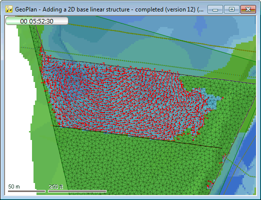

  21. Before wall collapse
    Before the wall collapses

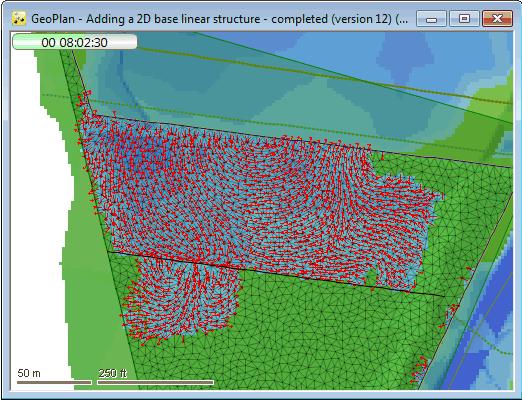

    After wall collapse
    After the wall collapses
