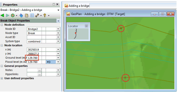

  3. If you wish set the Bridge1 node ground level to 130.72mAD in the node property sheet and the Bridge2 node ground level to 129.78mAD although break nodes do not necessarily need to have an assigned ground level.
  4. Two new break nodes

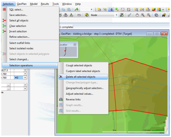

  5. Delete the short section of river reach between the two new break nodes:
    1. Select the link between the two nodes Bridge1 and Bridge2 with the Selection tool (Selection tool ) that can be found on the GeoPlan Tools toolbar.
    2. The short section delimited by the two break nodes is highlighted in red on the GeoPlan.
    3. Right-hand click on the highlighted section and select Selection | Selection operations | Delete all selected objects.
    4. Deleting the short section between the two break nodes
    5. The link is deleted from the network.

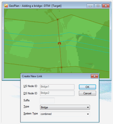

  6. Draw a new link upstream to downstream (South to North) between the two break nodes ensuring its type is set to Bridge:
    1. Set the New Object type to link and click on the New Object tool (New Object button ) of the GeoPlan Tools toolbar and digitise a link from Bridge1 to Bridge2.
    2. Note: It is important to draw the bridge upstream to downstream.
    3. Select Bridge: in the Type dropdown list and click on OK.
    4. Adding a new bridge link

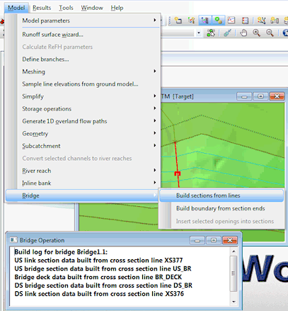

  7. To build the overall bridge structure from these section lines select the bridge link on the GeoPlan with the Selection button (Selection tool) and then select Model | Bridge | Build sections from lines. This will generate a report detailing the building of the bridge. Check the details and then close the report window.
  8. Building section from lines (bridges)
