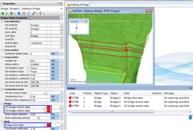

    1. Related data can be found in the corresponding sections in the bridge property sheet.
    2. Click on the Properties Tool (Properties button) from the GeoPlan Tools toolbar and then click on the bridge on the GeoPlan.
    3. The bridge property sheet is displayed and the US link section data, US bridge section data, DS bridge section data, Bridge deck data, and the DS link section data sections contain the corresponding data.
    4. As can be seen from the screenshot above, some red validation errors are being highlighted in the property sheet. We will deal with these very soon.

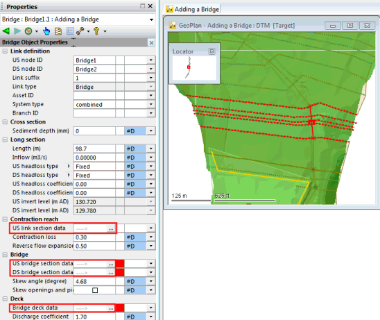

  3. Validate the Adding a bridge network:
    1. Ensure the network is open in the GeoPlan.
    2. Select the Validate button (Validate button) on the Validation toolbar.
    3. The Network Validation dialog is displayed.
    4. Click OK.
    5. The Output window shows that three of the above mentioned sections have validation errors against them:
    6. Validating the network
  4. As can be seen on the above screenshot, the Bridge property sheet shows that each of these sections is currently missing data (see red on-the-fly validation errors in the property sheet).
The validation process indicates that bridge openings need to be defined.
