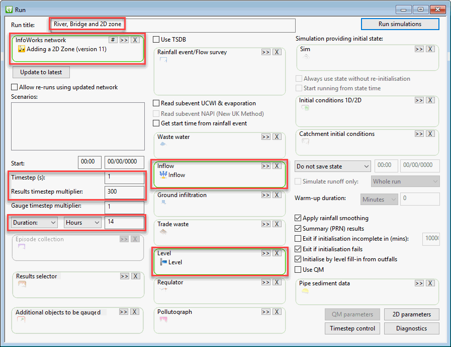

  3. Create a new run and define the run parameters as shown below:
    1. In the Explorer window, right click on the Model Group tree item and select New InfoWorks | Run to create a new run. The Schedule Hydraulic Run View dialog is displayed.
    2. In the Schedule Hydraulic Run View dialog:
      1. Enter a name in the Run title (River, Bridge and 2D zone)
      2. Drag and drop your network (Adding a 2D zone or Adding a 2D zone - step 2 completed) in the InfoWorks Network drop target.
      3. Drag and drop the Inflow hydrograph (set up in the River tutorial) in the Inflow drop target.
        1. If you have completed the River tutorial, both the Inflow and Level hydrograph will be available to pick in your database tree view in the Explorer window.
        2. If not, they can be copied from the provided transportable database. Open the transportable database by selecting File | Open | Open transportable database....
        3. In the new Explorer window that gets displayed with the contents of the transportable database, click on the Tree Plus button (expand) button to expand the Model Group.
        4. Right-click the Inflow hydrograph and select Copy from the popup menu.
        5. In the Explorer window of your current database, right-click on your Model Group tree item and select Paste: Inflow (with children).
        6. The Inflow hydrograph is copied in your database.
      4. Drag and drop the Level hydrograph (set up in the River tutorial) in the Level drop target. Please refer to the bullet point above for instructions on how to copy this hydrograph object from the provided transportable database in case you have not gone through the River tutorial.
      5. Set the Timestep to 1 second and the Results timestep multiplier to 300. (It is worth noting that 1D-2D models will typically have a lower timestep than 1D-only models.) In this example we are using 1 second, but around 5 seconds is perhaps more common.
      6. Set the Simulation time as 14 hours.
    3. Use all other suggested defaults throughout.
    4. Schedule Run View dialog
    5. Click Run simulations.
    6. In the Schedule Job(s) dialog, choose which computer will carry out the simulation (This Computer) and leave the other parameters as they are (store results locally and start the simulation now). Click OK to start.

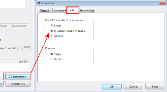

If your PC has one of the supported NVIDIA GPU cards installed, the simulation time can be reduced dramatically by activating the card prior to starting the simulation. This is done from the 2D parameters button on the Schedule Hydraulic Run View dialog.
2D parameters dialog - GPU tab
Select the GPU tab. If you are not sure whether your GPU card is supported, select the If suitable card is available option. If you are sure you have a suitable card, select Always. Note that if you select always, but your card is not actually supported, the run will fail.
The same run, completed on the same computer as detailed above, but with an NVIDIA GeForce GTX 580 GPU card active will complete the whole simulation in less than 2 minutes.
Note: When using a GPU card for carrying out 2D calculations, it is recommended that the latest available NVIDIA driver for the GPU card is installed.
