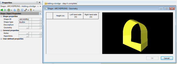

  2. To view the bridge opening:
    1. Click on the Properties Tool (Properties button) from the GeoPlan Tools toolbar and then click on the bridge opening on the GeoPlan.
    2. In the bridge opening property sheet, click on the small arrow adjacent to Shape ID and select Open shape ARCHSPRUNG. The "Archsprung" shape property sheet is displayed.
    3. Click on the Ellipsis button button adjacent to Geometry.
    4. The Shape dialog is displayed.
    5. View bridge opening
    6. Close the Shape dialog by clicking on the Close button button.

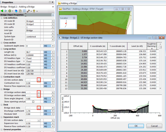

  3. The completed bridge can also be viewed:
    1. Click on the Properties Tool (Properties button) from the GeoPlan Tools toolbar and then click on the bridge on the GeoPlan.
    2. The bridge property sheet is displayed. Click on the Ellipsis button button adjacent to US link section data, US bridge section data, DS bridge section data, Bridge deck data, or DS link section data to view the corresponding data.
    3. Viewing bridge data in the software
    4. Once you have finished looking at the data, either click on the Close button button or the OK button to close every dialog.

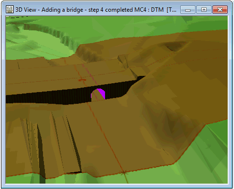

  4. The bridge can also be viewed in 3D:
    1. Zoom to the area to be viewed by using the Zoom in tool (Zoom in tool) of the GeoPlan Tools toolbar.
    2. Click on the 3D Network Window tool (3D Network Window tool) on the Windows toolbar to open a 3D window of the bridge.
    3. 3D View of the bridge
    4. Close the 3D view by clicking on the Close button button.
