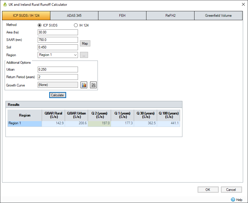

The IH 124 method is devised from a study aimed specifically at small catchments ( < 25 km²). Efforts are made to include a greater proportion of commonly found catchments which are relatively permeable, lowland and partly urbanised.
Note that although a site of 25 km² would be regarded as a large area for a new development, it is a small area by river catchment standards. Also, because of the wide variety of covering vegetation, land use, soil types, natural and formal drainage etc., it is more difficult to determine runoff accurately than on a fully sewered urban catchment.
The ICP SUDS method is based on Interim Code of Practise for Sustainable Drainage Systems, Chapter 6.
Sites > 200 ha FEH statistical and unit hydrograph methods should be applied where possible. If the FEH method is not considered applicable, then the IH 124 method should be used.
50 – 200 ha IH124 method applied directly as described in Method 1.
0 – 50 ha IH124 method applied with 50 ha in the formula. Results are linearly interpolated using the ratio of the development size to 50 ha.
Area - Catchment area which is adjusted to km2 for use in the equation.
SAAR - Average annual rainfall in mm (1941-1970) from FSR figure II.3.1 or equivalent. This can also be picked using the Map picker.
Soil - Soil index of the catchment from FSR figure I.4.18 or Wallingford Procedure Volume 3. Soil classes 1 to 5 have Soil Index values of 0.15, 0.3, 0.4, 0.45 and 0.5 respectively.
Region - Region number of the catchment based on FSR Figure I.2.4. This can be selected from the Region Picker.
Additional Options
Urban – Proportion of area urbanised expressed as a decimal 0.000.
Return Period - The program generates results for a range of return periods and the specified return period entered here.
Growth Curve - Click the Growth Curve details icon to open the Growth Curve Editor.

ICP SUDS
Peak flood flows for the 1-, 30- and 100-year return periods are displayed along with QBAR.
For sites of 50 ha or more, the outputs are calculated using the IH124 method directly.
For sites smaller than 50 ha, the IH124 method is applied to a 50 ha site and the results multiplied by a scale factor equal to the site area (in hectares) divided by 50.
