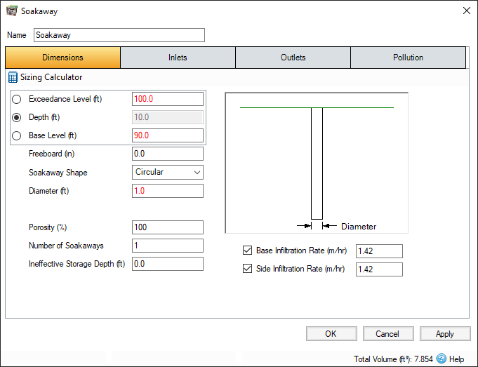

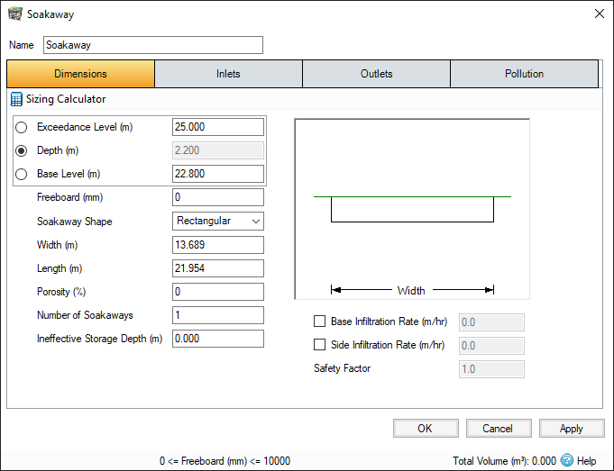

Dimensions
The Dimensions tab has the following fields:
Note: You can configure the dimensions of the Soakaway to act as a normal Soakaway or a Deep Bore Soakaway.
The depth within the stormwater control is determined from two of the following three parameters, with the third automatically calculated based on the option selected:
Freeboard – Controls how close to the specified Exceedance Level the water must reach before the Status (on the Summary) shows Flood Risk.
Soakaway shape – Rectangular/Square/Circular.
Width (Rectangular and Square shapes) – Width of Soakaway.
Diameter (Circular shape) – Diameter of Soakaway.
Length (Rectangular shape) – Diameter of Soakaway.
Note: Small values for Width, Diameter or Length will result in a narrow chamber which can result in instabilities due to rapid changes in water level.
Porosity – The percentage of the storage volume that is available for storage. This is dictated by the type of fill material that is used. I.e. Typically 30% for rubble.
Number of Soakaways – The number of Soakaways required.
Ineffective Storage Depth – The depth below the Exceedance Level that is unavailable for the storage of water.
Base Infiltration Rate – Defines the rate of infiltration through the base of the filter area. This should be determined from a performance site test.
Side Infiltration Rate – Defines the rate of infiltration through the sides of the filter area. This should be determined from a performance site test.
Safety Factor – Reduces the infiltration rate during the analysis to account for silting up or poor maintenance. This is required for the UK.
Note: This option may not be available for your region. For more information, refer to the Regionalisation topic.
Sizing Calculator:
The Sizing Calculator option allows the user to re-size the Soakaway by specifying a volume and a parameter to modify to achieve that volume.  The Sizing Calculator is discussed in more detail in the Stormwater Control Sizing Calculator section.

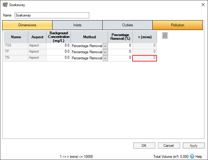

Pollution
The Pollution tab has the following fields:
Name – Name of pollutants. This is populated based on the Pollutants set up as part of the Site Data.
Background Concentration – Value below which the pollution concentration cannot fall during analysis. When concentration reaches this level, no further removal occurs.
Method – Percentage Removal or First Order Decay method can be chosen. Click on the links for more information about each method.
Percentage Removal – Available if Percentage Removal is entered. The value entered will be deducted from the Inflow into the system.
τ – The decay time constant or (mean) lifetime of the pollutant. It can be entered manually or calculated from the decay constant or decay half-life. See Pollutant Removal Method – First Order Decay for more details.
