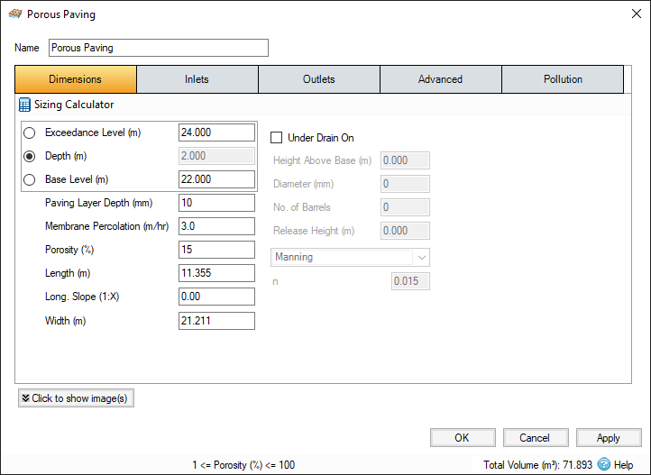

The Dimensions tab has the following fields:

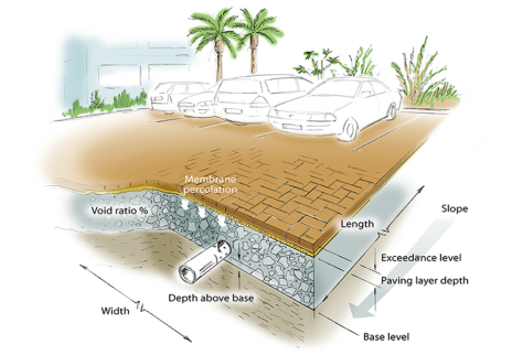

The depth within the stormwater control is determined from two of the following three parameters, with the third automatically calculated based on the option selected:
Paving Layer Depth – The depth of the paving blocks at the top of the stormwater control. This depth will be excluded from the available volume calculations.
Membrane Percolation – The rate at which water can pass through the membrane, under the paving and into the storage available.
Porosity – The percentage of the storage volume that is available for storage. This is dictated by the type of fill material that is used. I.e. Typically 30% for rubble.
Length – The maximum path length through the stormwater control, used only for the purpose of calculating Time of Travel. The Length will be automatically set from the dimensions of the stormwater control unless over-typed, in which case it is set to ‘user specified’.
Longitudinal Slope – Slope along the length of the stormwater control.
Width – The width of the stormwater control.
Under Drain On: Specifies whether a pipe or conduit underdrain is present in the lowest layer of the filter area. If under drain is on, the following can be specified:
Height Above Base – Height of the invert of the pipe above the base of the system.
Diameter – Defines the diameter of the pipe(s).
No. of Barrels – Represents the number of pipes.
Friction Scheme – Specifies the formula used to calculate velocity and time of travel. Select from: Manning's and Colebrook-White. The variable below the combo box depends on the option selected.
n – Manning’s n roughness value. Used by the Manning Formula equation to calculate the velocity, and therefore time of travel, when using the Manning's option.
Roughness – Colebrook-White roughness value. Used by the Colebrook-White Formula equation to calculate the velocity, and therefore time of travel, when using the Colebrook-White option.
Release Height – Height above the invert of the under-drain pipe at which the water is released (marked in red on the diagram below). This is commonly used to create a saturated zone.
Sizing Calculator
The Sizing Calculator option allows the user to re-size the Porous Paving by specifying a volume and a parameter to modify to achieve that volume. The Sizing Calculator is discussed in more detail in the Stormwater Control Sizing Calculator section.

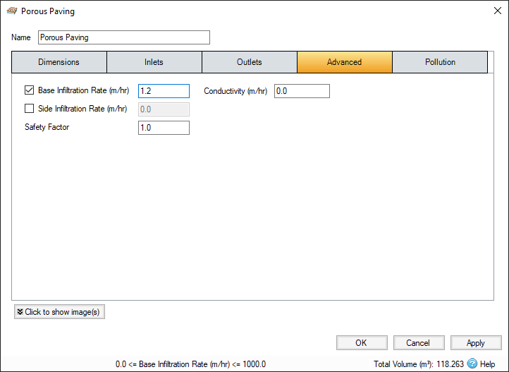

The Advanced tab has the following fields:
Base Infiltration Rate – Defines the rate of infiltration through the base of the filter area. This should be determined from a performance site test.
Side Infiltration Rate – Defines the rate of infiltration through the sides of the filter area. This should be determined from a performance site test.
Safety Factor – Reduces the infiltration rate during the analysis to account for silting up or poor maintenance. This is required for the UK.
Note: This option may not be available for your region. For more information, refer to the Regionalisation topic.
Conductivity – The conductivity rate is used for the calculation of both the horizontal and vertical transfer of the water in the sub-surface layers. Please refer to Guidance on Conductivity Rates for guidance on how to set these values depending on the type of material.

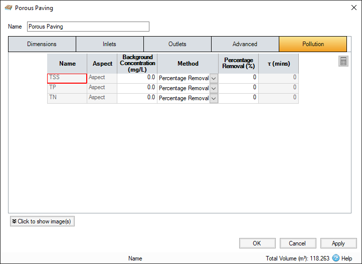

The Pollution tab has the following fields:
Name – Name of pollutants. This is populated based on the Pollutants set up as part of the Site Data.
Background Concentration – Value below which the pollution concentration cannot fall during analysis. When concentration reaches this level, no further removal occurs.
Method – Percentage Removal or  First Order Decay method can be chosen. Click on the links for more information about each method.
Percentage Removal – Available if Percentage Removal is entered. The value entered will be deducted from the Inflow into the system.
τ – The decay time constant or (mean) lifetime of the pollutant. It can be entered manually or calculated from the decay constant or decay half-life. See Pollutant Removal Method – First Order Decay for more details.
