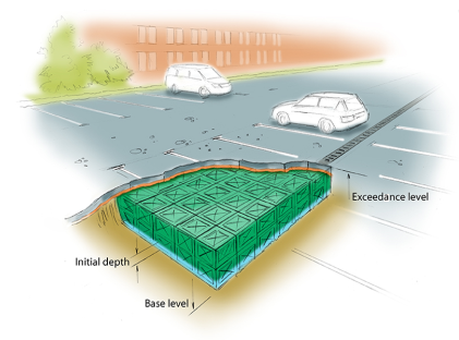

The depth within the stormwater control is determined from two of the following three parameters, with the third automatically calculated based on the option selected:
Freeboard – Controls how close to the specified Exceedance level the water must reach before the Status (on the Summary) shows Flood Risk.
Initial Depth – Defines the initial wetted depth within the facility.
Porosity – Defines the percentage of the tank that is available for storage. This is dictated by the type of fill material that is used, i.e. 100% if empty or typically 30% for rubble.

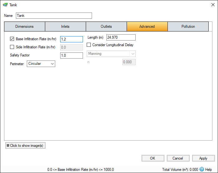

The Advanced tab has the following fields:
Base Infiltration Rate – Defines the rate of infiltration through the base of the filter area. This should be determined from a performance site test.
Side Infiltration Rate – Defines the rate of infiltration through the sides of the filter area. This should be determined from a performance site test.
Safety Factor – Reduces the infiltration rate during the analysis to account for silting up or poor maintenance. This is required for the UK.
Note: This option may not be available for your region. For more information, refer to the Regionalisation topic.
Perimeter – Specified whether the perimeter shape for the side infiltration calculation is to be circular or square. The default is circular.
Length – The maximum path length through the stormwater control, used only for the purpose of calculating Time of Travel. The Length will be automatically set from the dimensions of the stormwater control unless over-typed, in which case it is set to ‘user-specified’.
Consider Longitudinal Delay – Determines if a time of travel needs to be considered across the structure. This may not be required, as they are laid flat and can be considered as filling instantaneously. If the travel time is to be considered, a roughness method and value should be selected.
Friction Scheme – Specifies the formula used to calculate velocity and time of travel. Select from: Manning's and Colebrook-White. The variable below the combo box depends on the option selected.
n – Manning’s n roughness value. Used by the Manning Formula equation to calculate the velocity, and therefore time of travel, when using the Manning's option.
Roughness – Colebrook-White roughness value. Used by the Colebrook-White Formula equation to calculate the velocity, and therefore time of travel, when using the Colebrook-White option.

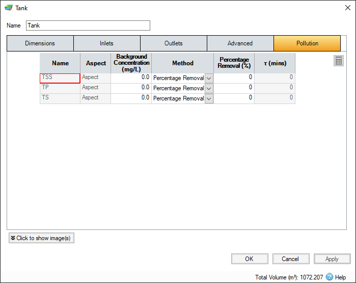

Pollution
The Pollution tab has the following fields:
Name – Name of pollutants. This is populated based on the Pollutants set up as part of the Site Data.
Background Concentration – Value below which the pollution concentration cannot fall during analysis. When concentration reaches this level, no further removal occurs.
Method – Percentage Removal or First Order Decay method can be chosen. Click on the links for more information about each method.
Percentage Removal – Available if Percentage Removal is entered. The value entered will be deducted from the Inflow into the system.
τ – The decay time constant or (mean) lifetime of the pollutant. It can be entered manually or calculated from the decay constant or decay half-life. See Pollutant Removal Method – First Order Decay for more details.
