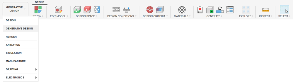

To use Generative Design, you need to work in the Generative Design workspace, which you can access from the Workspace menu list.

If you can't see the Generative Design workspace watch this short video:
When in the Generative Design workspace, use the tools to work through the different stages of creating a generatively designed part. These stages are:
