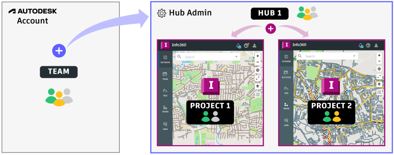

1: Create a hub and activate Info360 Asset
To activate Info360 Asset, a Team Admin must create a hub. This is done from your Autodesk Account. A hub is associated with a team and contains one or more projects and their members. You can have one or more hubs (max. 10) per team (e.g., for different regions).
Note: If you have more than one team, you will need to create a hub for each team.
Learn how:
Once you've created your hub in Autodesk Account, go to Hub Administration.

4: Create a project
Within the hub, a Hub Admin must create a project. A project is a sub-container within a hub and is where project members can work in Info360 Asset with the project's data. You can have multiple projects per hub.
Note: Data is not shared between projects.
