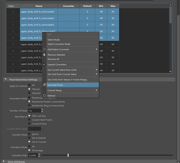

  6. Before proceeding, make sure you've either generated poses, provided poses from existing animations, or done both. This step is crucial for accurate deformation training.
    Generating Poses
