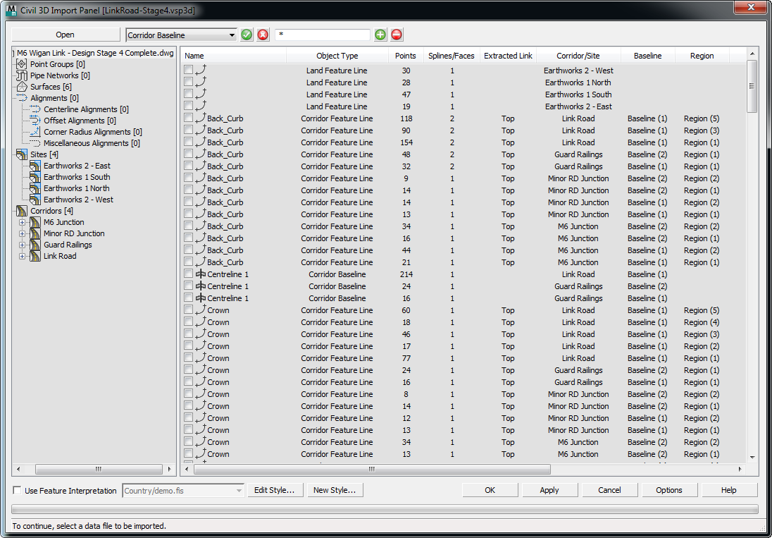

Civil 3D Import Panel
Lets you import AutoCAD Civil 3D data into Civil View.

Interface
Open
Click to open a file dialog and browse to the VSP3D file you want to use.

[selection options]
This group of controls provides filtering options to help you select portions of one or more models.
[string type drop-down list]
Lets you choose either All Strings (the default), or one of the particular string types available in the active model.
[check-mark button]
Click to select the strings that match your choice from the drop-down list.
[X button]
Click to deselect the strings you have selected.
[wildcard field]
Lets you narrow the string selection by entering a wildcard expression. Default = * (select all).
You can also use the file contents list to select strings individually, or right-click the list to see a menu with additional selection options.
[plus-sign button]
Click to select those strings that match the wildcard field.
[minus-sign button]
Click to deselect those strings that match the wildcard field.
[hierarchy view]
Shows the full hierarchy of the Civil 3D data set. Click within this tree to select a parent object; for example, a specific corridor, corridor region, or site. The Civil 3D Import panel displays the children of that object in the list view to the right.
Right-click the hierarchy to open a menu that lets you select all objects that are children of the parent.
To see all objects in the list view, select the root node at the very top of the hierarchy.
[list view]
Lists the objects are related to the parent object selected in the hierarchy.
Right-click the list view to open a menu with selection options such as matching name, object type, corridor, layer, or assembly.
This list includes the following columns of information:
  • Name The name of the Civil 3D object.
  • Object Type The type of the Civil 3D object; for example, surface, alignment, featureline, corridor surface, and so on.
  • Points For shapes, the total number of points in the shape. For surfaces, the total number of vertices in the mesh.
  • Splines/Faces For shapes, the total number of splines in the shape. For surfaces, the total number of faces (triangles) in the mesh.
  • Extracted Link The extracted link code that was specified during the export process from Civil 3D. Applies to corridor-related objects only.
    The Civil View Exporter for Civil 3D allows the exported data from a corridor to be filtered by corridor link code.  Usually you will use the link code "top" to ensure that only the top surface of a corridor is exported for visualization purposes.
  • Corridor/Site The name of the parent or container to which the listed object is related. For corridor surfaces, alignments, and featurelines, the name of the corridor is listed. For site/grading feature lines, the name of the site is listed. Applies to corridor- and site-related objects only.
  • Baseline The baseline to which the listed corridor object is related. Applies to corridor-related objects only.
  • Region The region to which the listed corridor object is related. Applies to corridor-related objects only.
  • Assembly The assembly that was applied to the region to which the listed corridor object is related. Applies to corridor-related objects only.
  • Start Station The start station of the region or baseline to which the listed corridor object is related. Applies to corridor-related objects only.
  • End Station The end station of the region or baseline to which the listed corridor object is related. Applies to corridor-related objects only.
  • AutoCAD Layer The AutoCAD layer from which the listed object was extracted.
Some objects in the list might be appear grayed out. This can happen for one of a couple reasons:
  • The object has already been imported into the current scene. Civil View automatically checks all object and model names against previously imported objects. If any identical object name or model name combination already exists in the current scene, the corresponding list item is disabled.
  • The object type is not supported by Civil View.
