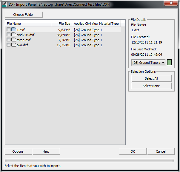

Interface
- Choose Folder
- Click to open a dialog where you can browse to folder that contains the DXF files you want to use.
- [file list]
- Lists all DXF files in the active directory. Also shows the size of each file in kilobytes, and the CivilViewSurfaces material channel associated with each file (see below).
You can select an individual file in the list by turning on its checkbox.
DXF File Details group
Shows details about the currently highlighted file.
- [material channel drop-down list]
- Shows the sub-material and wireframe color assigned to the highlighted DXF file. The sub-materials are channels of the CivilViewSurfaces material.
By default, the sub-material assignment is derived from the first character of the DXF file name, according to the following convention (this convention is case-sensitive):

You can use the drop-down list to change the default sub-material assignment, and the color swatch to change the default wireframe color.
Selection Options group
- Select All
- Click to select all files in the list.
- Select None
- Click to deselect all files in the list.
- Options
- Click to open the Import Options tab of the Civil View Preferences panel, where you can set a range of geometry import defaults, such as the mesh smoothing threshold angle.
