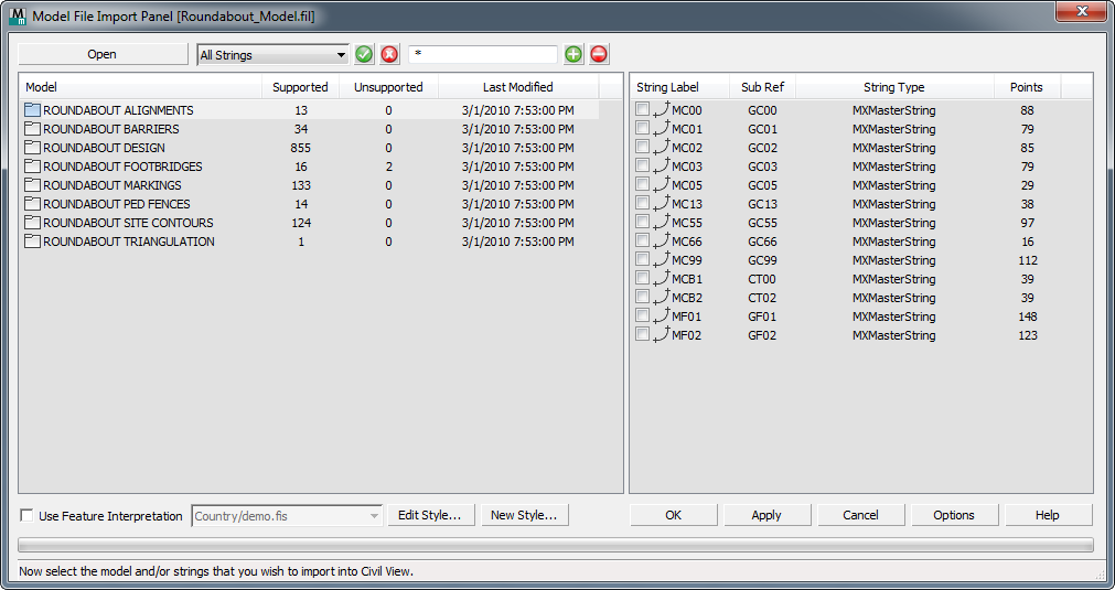

Interface
- Open
- Click to open a file dialog and browse to the MX file you want to use.
Important Notes
- In Civil View, you cannot open an MX Model File that is currently open in MX.
- MX strings that contain discontinuities are imported as single shape objects containing multiple splines.
- Import only strings that are likely to form part of the visualization. Importing MX strings that you do not need for visualization purposes will slow the performance of 3ds Max. You can always import additional MX strings at a later stage.
- All null levels found on imported MX strings are converted to a level of 0.000.
- Civil View remembers which MX strings have been imported into each scene, preventing the same string from being imported more than once.
[selection options]
This group of controls provides filtering options to help you select portions of one or more models.
- [string type drop-down list]
- Lets you choose either All Strings (the default), or one of the particular string types available in the active model.
[check-mark button] - Click to select the strings that match your choice from the drop-down list.
[X button]- Click to deselect the strings you have selected.
- [wildcard field]
- Lets you narrow the string selection by entering a wildcard expression. Default = * (select all).
You can also use the file contents list to select strings individually, or right-click the list to see a menu with additional selection options.
[plus-sign button]- Click to select those strings that match the wildcard field.
[minus-sign button]- Click to deselect those strings that match the wildcard field.
- [model list]
- Lists the models in the MX project. Click a model to highlight it. You can highlight only one model at a time, although you can select strings from multiple models before you finish using the Model File Import panel.
- [file contents list]
Lists the strings contained in the highlighted model, by label. This list also shows the string type and number of points. For triangulation strings, the number of triangles found in each string is also displayed.
Some string labels in the list might be grayed out. This can happen for a couple of reasons:
- The string has already been imported into the current scene.
Civil View automatically checks all string and model names against previously imported strings. If any identical string label and model name combination already exists in the current scene, the corresponding list item is disabled.
- The string type is not supported by Civil View.
