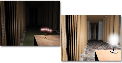

Intensity
The intensity of light at its point of origin affects how brightly the light illuminates an object. A dim light cast on a brightly colored object shows only dim colors.
Left: A room lit by candles, which are a low-intensity source.
Right: The same room lit by a higher-intensity light bulb.

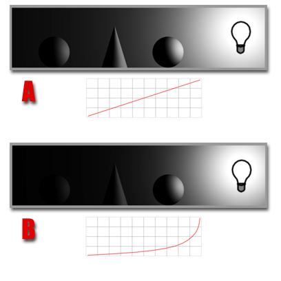

Attenuation
In the real world, light diminishes over distance. Objects far from the light source appear darker; objects near the source appear brighter. This effect is known as attenuation.
In nature, light attenuates at an inverse square rate. That is, its intensity diminishes in proportion to the square of the distance from the light source. It is common for attenuation to be even greater when light is dispersed by the atmosphere, especially when there are dust particles in the atmosphere, or fog or clouds.
A. Inverse decay
B. Inverse square decay
The graphs show the decay curves.

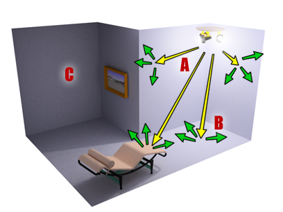

Reflected Light and Ambient Light
The light an object reflects can illuminate other objects. The more light a surface reflects, the more light it contributes to illuminating other objects in its environment.
Reflected light creates ambient light. Ambient light has a uniform intensity and is uniformly diffuse. It has no discernible source and no discernible direction.
A. Direct light
B. Reflected light
C. Resulting ambient light
