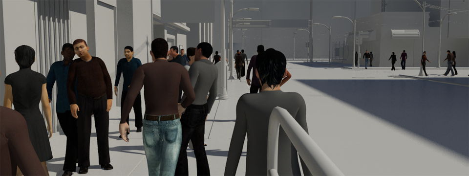

The Populate toolset lets you add animated characters to your scene quickly and easily. The characters can walk along paths, or flows, and others can hang out in idle areas or sit on seats. The flows can be as simple or as complex as you like, and can include shallow inclines and declines.
- Flow: A pathway for walkers that resembles a sidewalk or hallway. A flow consists of one or more connected straight-line flow segments that you create by clicking and moving the mouse in a viewport. When a flow is correctly formed, with permissible angles between segments and of inclines, parallel lines indicating pedestrian paths appear along its length. At the endpoints of each line are arrows indicating its flow direction. Also, red and blue marks on flows indicate starting points and walking directions of female and male people, respectively.
You can edit existing flows by moving segments and their endpoints, known as flow points. You can also subdivide a flow to add complexity to the path. You can also create inclines and declines, also known as ramps, which have their own markings.
Where two flows intersect, a green cross-shaped arrow appears. This indicates that walkers on one flow can change direction at random to move to the intersecting flow.
Each flow has two portals: Portal 1 and Portal 2. The portal is the direction from which pedestrians appear on the flow.
- Idle Area: A region separate from the flows where people congregate, such as a park or traffic island. Settings include density and how the people form groups of interacting characters. Idle areas are always distinct from flows; Populate does not support the passage of people between the two.
- Seat: A box-shaped object on which one person sits. You can place seats on idle areas or anywhere else in the scene. People sitting on seats can interact with people sitting on nearby seats, or they can behave as if they are alone.
- People: The virtual humans in the Populate simulation. You can adjust their appearance by setting a skin type, from stick figure to textured skin, by regenerating their look, swapping their appearance, and by switching between resolutions. Otherwise, you control Populate people indirectly by adjusting settings described in these topics.
