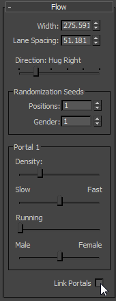

- Go to the
Modify panel. On the Flow rollout, click to turn off Link Portals.
The label on the main Flow rollout changes to indicate that this group controls Portal 1. Controls on the Portal 2 rollout are now available, too.
In addition, numbers appear in the viewports to show which portal is which:

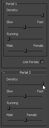

- In both Portal groups, drag the Density slider all the way to the right (full Density).
- In the Flow rollout
Portal 1 group, drag the Slow/Fast slider all the way to the left.
- On the Portal 2 rollout, drag the Running slider all the way to the right.
