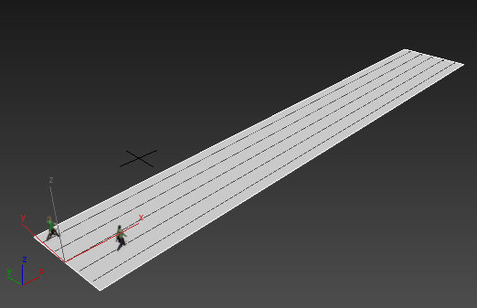

Simulate again:
- On the Simulate panel, click
once more. - When the simulation is done,
play the animation. The animation begins as the previous animation did, but after frame 200 more and more runners appear.
