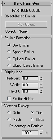

Basic Parameters rollout
Object-Based Emitter group
Lets you select a renderable mesh object to use as a particle emitter. This object is used only when the Object-Based Emitter option is chosen in the Particle Formation group.
Pick Object
Click this, and then select a renderable mesh object to be used as a custom emitter.
Object
Displays the name of the picked object.
These options let you specify the shape of the emitter.
  • Box Emitter Chooses a box-shaped emitter.
  • Sphere Emitter Chooses a sphere-shaped emitter.
  • Cylinder Emitter Chooses a cylindrical emitter.
  • Object-Based Emitter Chooses the object selected in the Object-Based Emitter group.
    Note: With regard to animation of the object-based emitter, the particles will properly fill a deformed object at frame 0, but they can't stay with the emitter while it's moving. If the emitter moves in a straight line, this can give the appearance of the cloud moving with the emitter.
Display Icon group
These options let you adjust the dimensions of the emitter icon when a custom object is not used as an emitter. When a custom object is used you can still resize the "Fill" icon using these options.
Rad/Len
Adjusts the radius of a spherical or cylindrical icon, and the length of a box icon.
Width
Sets the width of a box emitter.
Height
Sets the height of a box or cylindrical emitter.
Emitter Hidden
Hides the emitter.
