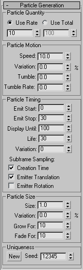

Particle Generation rollout
Particle Motion group
Specifies the number, size, and motion of particles.
- Speed
- The speed of the particle at birth, in units per frame.
- Variation
- Applies a percentage of variation to the speed of emission for each particle.
- Tumble
- Amount of random rotation of the particles.
- Tumble Rate
- Speed at which the particles rotate.

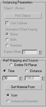

Particle Type rollout
Mat'l Mapping and Source group
- Emitter Fit Planar
- Maps particles at birth, based on their point of emission from the rectangular Blizzard emitter icon. The UV range of the mapped material runs from 0 to 1 over the width and length of the emitter.
