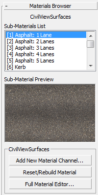

Provides an overview of the Civil View materials loaded into the current scene.
  • Civil View Explorer > Upper panel > Civil View Materials branch > Click a material entry. > Materials Browser rollout
[material name]
Shows the name of the selected material.
Sub-Materials List
Shows all material channels in the selected material.
Sub-Material Preview
Displays a preview of the highlighted sub-material.
[material name] Material group
Add New Material Channel
Click to choose a bitmap for a new material channel. Civil View copies the selected bitmap to the relevant folder within any current Civil View Resource Kit, then loads the map into the diffuse slot of the new material channel.
This button is available for these Civil View materials:
Civil View automatically manages the content of other Civil View material types.
Reset/Rebuild Material
Resets the Civil View material to its default state. Changes you have made to this material are lost.
Full Material Editor
Click to open the full 3ds Max Material Editor for more complex material-editing tasks.
