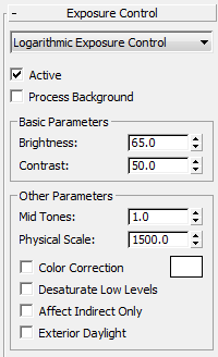

Logarithmic Exposure Control
Logarithmic Exposure Control uses brightness, contrast, and whether the scene is outdoors in daylight to map physical values to RGB values. Logarithmic Exposure Control is better for scenes with a high dynamic range.
The controls for the Logarithmic exposure control are the same as for Automatic exposure control, with two additional settings:
- Affect Indirect Only
- When on, Logarithmic Exposure control is applied only to areas of indirect lighting. Default=off.
Turn on this toggle when the primary lighting for your scene comes from standard lights rather than photometric lights. When you use standard lights and turn on Affect Indirect Only, radiosity and exposure control yield results similar to the default scanline renderer. When you use standard lights but leave Affect Indirect Only off, radiosity and exposure control yield results that can be quite different from the default scanline renderer.
- Exterior daylight
- When on, converts colors for an outdoor scene. Default=off.
The exterior daylight setting compensates for the extreme intensity of an IES sun light.

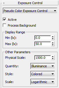

Pseudo Color Exposure Control
Pseudo Color Exposure Control is actually a lighting analysis tool that provides you with a way to visualize and evaluate the lighting levels in your scene. It maps luminance or illuminance values to pseudo colors that show the brightness of the values being converted.
From darkest to brightest, the rendering shows blue, cyan, green, yellow, orange, and red. (Alternatively, you can choose a grayscale where the brightest values are white and the darkest are black.) The rendering includes the color or grayscale spectrum bar as a legend for the image.
Pseudo color exposure of a scene with radiosity. Areas in red are overlit, areas in blue are underlit, and areas in green have a good lighting level.
Display Range group
- Min[imum] (lx)
- Sets the lowest value to measure and represent in the rendering. Values at this quantity or below it all map to the leftmost display color or grayscale level.
- Max[imum] (lx)
- Sets the highest value to measure and represent in the rendering. Values at this quantity or above it all map to the rightmost display color or grayscale value.
Other Parameters group
- Physical Scale
- Sets a physical scale for exposure control to use with lights that are not physically based. The result is an adjustment of the rendering that approximates the eye's response to the scene.
- Quantity
- Chooses the value being measured:
- Illuminance (The default.) Displays values of light incident on surfaces.
- Luminance Displays values of light reflected off surfaces.
- Style
- Chooses the way to display values:
- Colored (The default,) Shows a spectrum.
- Grey Scale Shows gray tones that range from white to black.
- Scale
- Chooses the technique used to map values:
Logarithmic (The default.) Uses a logarithmic scale.
This option is useful when the illumination of the surfaces of interest is low compared to the maximum illumination in the scene.
- Linear Uses a linear scale.

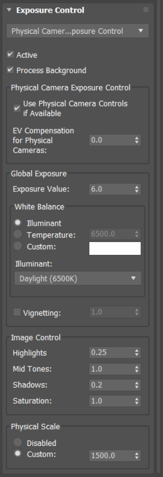

Physical Camera Exposure Control
This control sets exposure for Physical Cameras, using an Exposure Value and color-response curve.
This control is a duplicate of the one found under Rendering menu > Environment > Environment and Effects dialog. For more information, see Physical Camera Exposure Control
