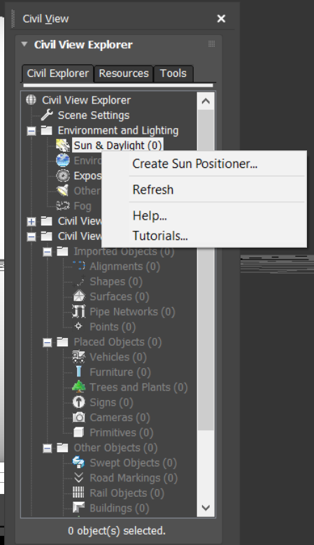

The easiest way to add a Daylight system to your Civil View scene is to right-click the Sun and Daylight node on the Civil View Explorer, and choose Create Sun Positioner.
After choosing this option, 3ds Max prompts you to create a Sun Positioner and Physical Sky. Click and drag in the viewport to set up the compass and sun light for the Sun Positioner system. See Sun Positioner and Physical Sky.
