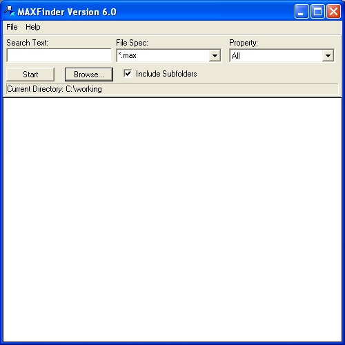

[MAXFinder window]
- Search Text
Specifies the text to search for. If you leave the field empty, all files that contain the specified property will be found.
- File Spec
Specifies which file types to search through. The predefined file type is *.max. You can enter a different file type, such as *.dwg. To search through all files, use *.*.
The currently selected item in this list is restored the next time you run Finder.
- Property
Specifies the property you want to search for. Use All to search for any property.
- Start
Activates the search. During a search, the button title switches to Cancel. Click Cancel to abort the search.
- Browse
Specifies the directory for the search, using the standard Windows Browse for Folder dialog.
- Include Subfolders
When on, Finder searches the current directory and all subdirectories. When off, only the current directory is searched.
- [file list]
Lists all files that were found and match the current search criteria.
Double-click a found file in this list to display the property viewer for the file. The information presented in this dialog is similar to that displayed with Application menu
Properties
File Properties inside 3ds Max. Use the << and >> buttons to step to the previous or the next file in the found list. While in the property viewer, the search continues in the background.
