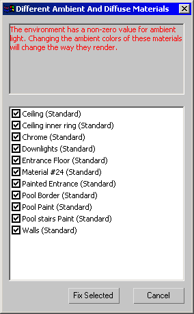

Different Ambient and Diffuse Materials
This dialog appears after clicking Find All or Find Selected.
- [status message]
- This area displays a message indicating whether your scene (or selection) has materials with different ambient and diffuse values.
- [material list]
- Lists all of the materials with different ambient and diffuse values.
- Fix Selected
- Locks the ambient and diffuse channel for the materials selected in the dialog.
- Cancel
- Closes the dialog without making any changes.
