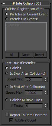

Interface
- Particles In Current Event
- When this first option is set to Particles In Current Event, the test checks for collisions in the event in which the mParticles InterCollision test resides. In some cases, particles in the current event might collide with nearby particles after the latter have already moved on to another event; if this option is active, such collisions would not register.
- Particles In Events:
- The test checks for collisions in all highlighted events in the list (the list always contains all events in the flow). To check for collisions between particles in the current event and other events, highlight the events to check. mParticles InterCollision does not check for collisions between particles in other events only.
For example, you might have a large grid of particles that fall onto an object due to gravity; most of those will collide with one or more neighboring particles at some point in the first event (Event 01); using the Collides option, each colliding particle moves on immediately to the next event. But a few might not collide until all of their neighbors move on to the next event (Event 02). If you choose Particles In Events and highlight both events, mParticles Intercollision will continue to test for collisions and the remaining particles will eventually pass the test and move to Event 02.
For a video showing the effects of the Particles In Current Event and Particles In Events options, see mP InterCollision Test Videos.
- [event list]
- Lists all events in the flow. When using the Particles In Events option, highlight list members to check for collisions between particles in the current event and the highlighted events.
- All/None/Invert
- All highlights all events in the list; None removes highlighting from all events in the list; Invert removes highlighting from highlighted events and highlights the rest.
Test True If Particle group
The Collides, Is Slow After Collision(s), Is Fast After Collision(s), and Collided Multiple Times options and controls are similar to those in the standard Collision test, with a few differences:
- Collides This option does not have a drop-down list to define the following particle velocity. During simulation a particle has to collide and further velocity is a result of a deflection, so it doesn't make sense to provide the choice of bounce, or stop, or continue. By definition, it's always a bounce.
The collisions are counted during the whole integration step. The test directs particles to the next event only after simulation of the integration step is completed. Effectively, a particle can collide multiple times during an integration step; it will be redirected to the next event if you use the Collides option. The particle, however, is not redirected to the next event immediately after its first collision; it is redirected as a fact of a collision during the integration step.
- Collided Multiple Times Similarly, with this option, a particle is redirected to the next event if during the integration step (and in previous frames cumulatively) if it collided with the deflector at least the specified number of times. And again, it's not redirected to the next event right away, at the moment it collides for the Nth time; it's redirected to the next event at the end of the integration step if the cumulative number of collisions exceeds the value in # Times spinner.
- Will Collide Unavailable.
- Report To Data Operator
- When using the advanced data manipulation tools, enable this option if you need the number-of-collisions data to be used by a Data operator. You can use the Input mParticles sub-operator to retrieve these data in a Data operator.
Available when Test True If Particle is on. Typically you'd use this when the test is not wired to any following event.
- Additive Count
- When on, the reported data represent the total number of collisions a particle had while present in the current event. When off, the test reports only the number of collisions a particle experienced during the last integration step.
Available only when Report To Data Operator is on.
